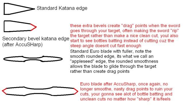

The problem with both the Lansky and Accusharp is that they create a secondary bevel and a good sword used properly shouldn't need sharpening for a very long time.

Moon wrote:The problem with both the Lansky and Accusharp is that they create a secondary bevel and a good sword used properly shouldn't need sharpening for a very long time.
Yea but look at the damage that could be done with a whetstone or the lansky delux, in a untrained hand the edge will be totally ruined....
